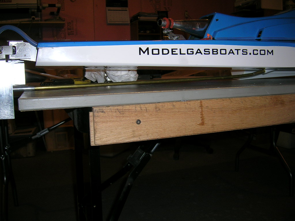

To properly setup a hydroplane you HAVE TO have a FLAT table or setup board to work on. This surface must be wide enough for the sponsons to both sit flat on and must be long enough to span from the strut to the sponsons.
The first thing to do is to set your boat on the table with the turn fin hanging off the side but both sponsons and the strut laying flat on the surface.

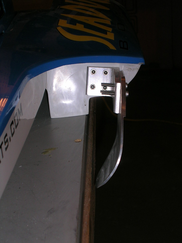

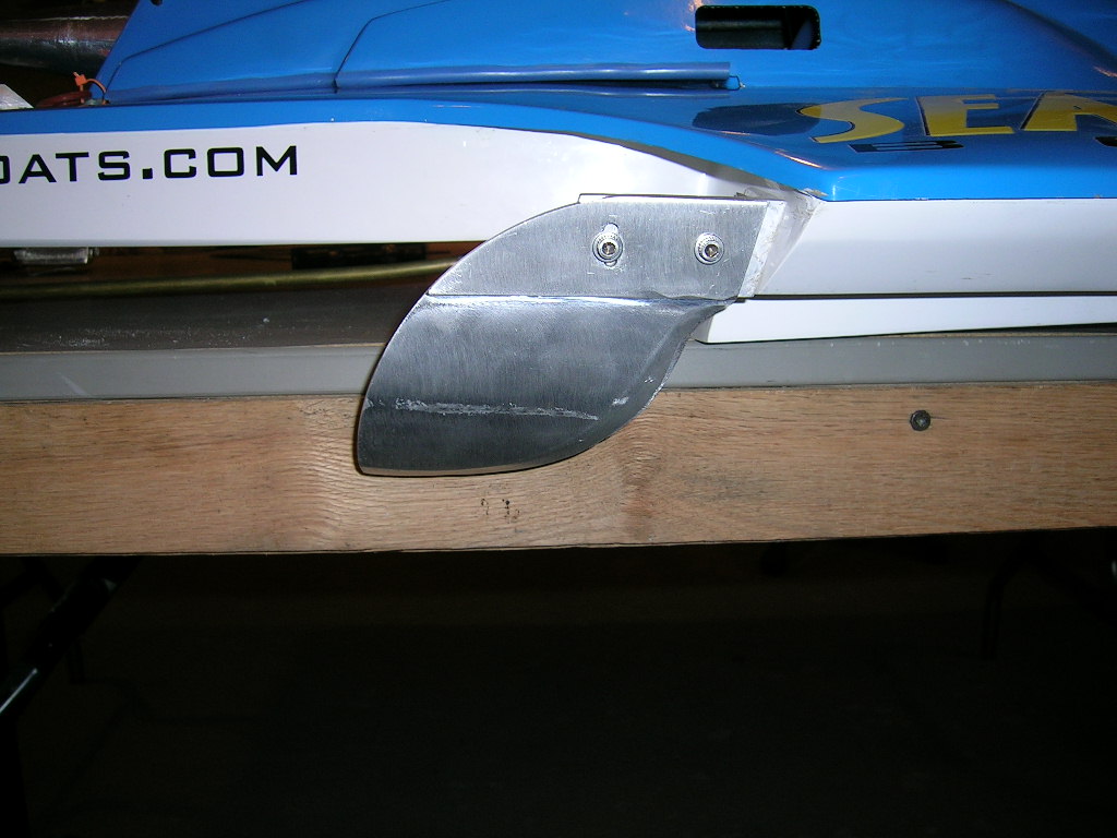

There are two different types of turn fins more commonly seen on hydros. One has a straight bend and the other is a curved type. Both are pictured below. In most cases the manufacturer will specify where to mount the turn fin and how to adjust it. Some will even pre-mount the bracket for you. Again this varies from hull to hull. What I want to discuss here is more how to tune the fin for desired performance using tilt.
Image Image Image
Tilting the fin forward (bottom of fin towards the front of the boat) will have a tendency to make the boat track to the left and exert some lifting force on the right (starboard) sponson.
Tilting the fin back (bottom of fin towards the back of the boat) will have a tendency to make the boat track to the right and pull down on the right (starboard) sponson.

This isn't an adjustment, but more something that you should pay special attention to when building your hydro. What I am talking about is the stuffing tube. The stuffing tube on a hydro is very long. In theory the hydro rides on the front sponsons and the propeller (assuming there are no rear sponsons as seen on some outriggers and other hydros) but the fact is that in reality the stuffing tube is quite frequently in the water. For this reason you should keep it as straight as possible from the point it exits the hull to the point where it reaches the strut. You can easily imagine the effects it can have on performance if it's crooked and in the water when the hull is running 60mph plus!
