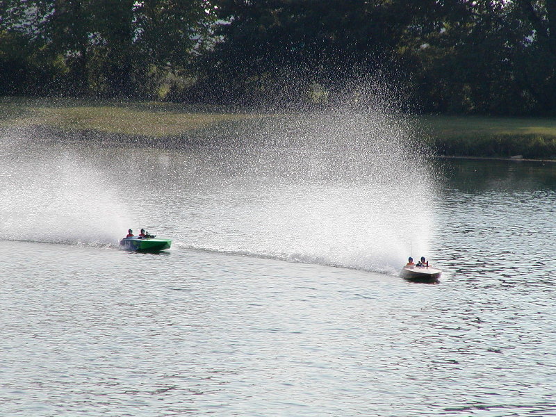

Q. Does anyone have a crackerbox up in your part of the country?
Could someone send me a picture of their CrackerBox?
Could someone send me pictures of a crackerbox actually running?
Does anyone race these?
Any basic feed back on CrackerBox?
ImageA. I'll try to sum these up for you. I am in Northern Ohio and the club I belong to had only two boats of this class two years ago and now there are 6 or 7 and I know of at least two more being built. They are becoming quite popular here. I am also aware of regional and national events where up to 20 CB have registered for competition.
