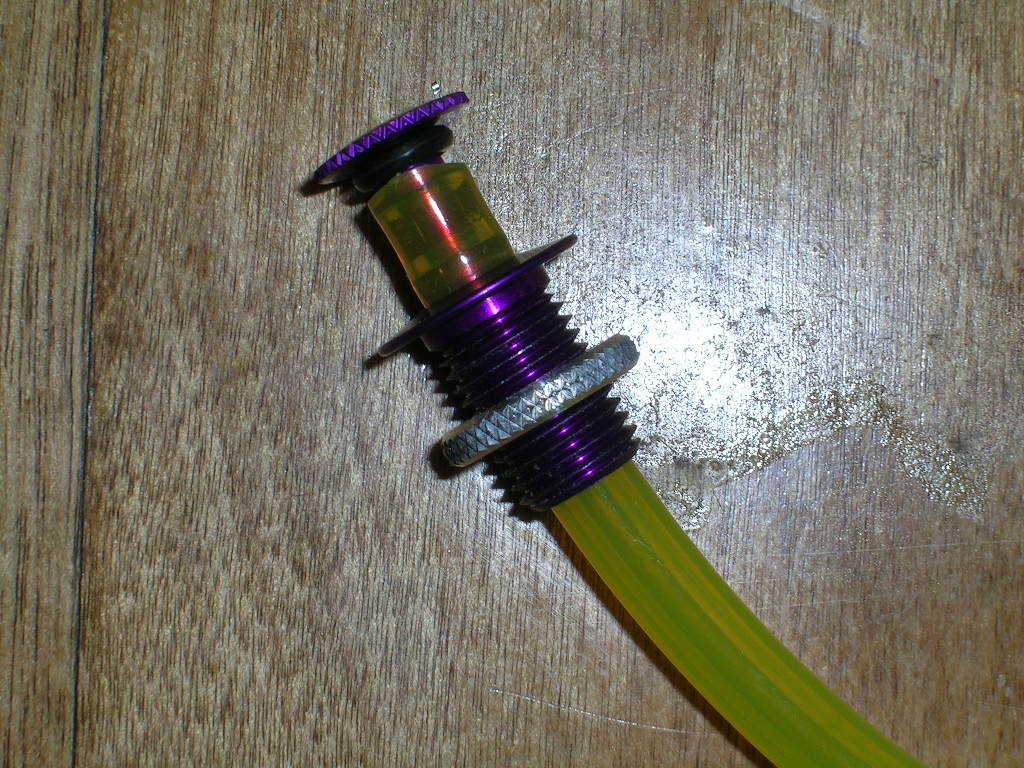

The bags can be purchases with or without the barbed fitting (I recommend this fitting). You can also purchase the fitting separately if you need some for other bags you already have. There are also bag "setups" available that come with the bag, the fitting, tubing, a "T" fitting and a plug or "through hull" Dot. These are very nice setups that really make it easy to install a gas bag system in your boats. All that is left to do, if you go with a complete setup, is to install a fuel filter on the feed line between your engine's carburetor and the "T" fitting on the setup.
500ml Bag Setup with DOTDOT pulled outDOT Pressed in

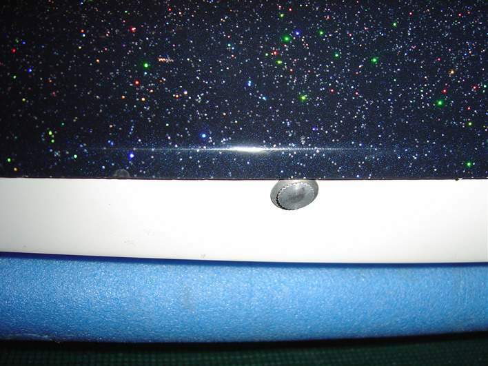

Below is what a DOT looks like when installed on a boat.
Fuel DOT installed on boat
I have been using one of these bag setups in my boat now for a couple months and I am happy to report that I have had no problems to date. No signs of weakening of the bag, no leakage. With the "T" fitting and plug (you can use a DOT also) refueling and emptying of the bag is a quick and easy job. The plug and all fittings seal well so there are no "air leak" problems either.
