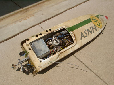

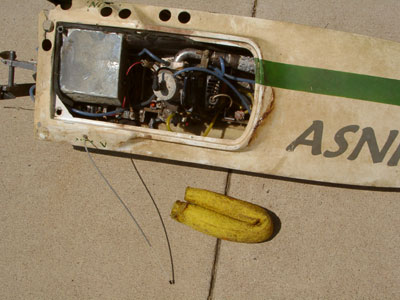

Early the next morning I received a phone call from a woman asking if I had lost a boat in the Potomac! I was stunned! I quickly ran out and picked up my lost boat. The boat looked pretty beat up. It was covered in grime and had a terrible stench from soaking in the river water. I thanked the family profusely for doing such a kind deed and shook the young man's hand, thanking him for "doing the right thing" (I also left him with a thank you note with a little gift in it).

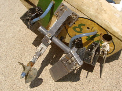

ImageThe hull had significant damage to the left transom area. It looked like the stern was bouncing on the riverbed, pounding against the rocks. The other components of the boat looked pretty messy also, and some of the aluminum parts had quite a bit of corrosion on them.

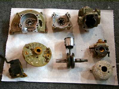

Surprisingly, after cleaning up all the parts and taking the motor apart, I was able to save virtually everything from the boat. The only part I didn't reuse was the carburetor. The motor came out in really good shape. Although there was water in the case, none of the bearings had rusted. The receiver and servos are all functioning fine. I poured the water out of the cases and sprayed them with CorrosionX and they came back to life.
