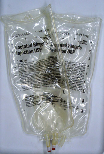

Bags commonly used in RC Boats are IV bags which typically come in two sizes, 1000ml and 500ml. A 1000ml bag holds a whopping 33 ounces of gas when full; so most people who run them do not fill them completely unless they are trying to test the battery capacity of their radio! For most racers and recreational boaters, a 500ml bag is compact and easy to fit anywhere inside the hull.
Availability of the bags can vary. Some medical supply houses will sell them, others won't. Likewise, some clinics or vets may make discarded ones available to you, others will not. If you do seek used bags, make sure to ONLY use saline bags. In some instances, it may be illegal to sell, distribute or possess "used" IV bags for anything except saline.
Bags must be made from a plastic compatible with gasoline. Bags made from PL146 plastic (Baxter) are known to be resistant to gasoline. An alternative to IV Bags are incontinence bags. These can be purchased online from medical supply stores like www.ocumedical.com or www.allegromedical.com (Allegiance (Baxter) Leg Bags). There are quite a few people who frequent Jim's R/C Boat Dock who have the bags available. Baxter Medical Supply may be a source that will sell the bags. There are many other places to get them, so post a message on Jim's, and someone will probably offer assistance.

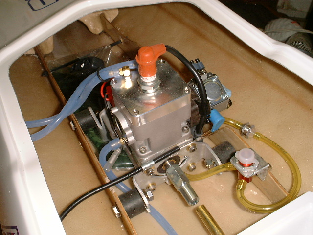

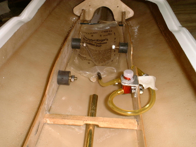

Plan for success, then mount the bag. Mounting methods basically fall into two categories; Lay it flaImaget in the hull, or hang the bag from a hook mounted under the deck or side of the boat. If the bag is laid flat in the bottom of the hull, it may be necessary to remove all the air from the bag – called "burping" the bag. A flat bag install does allow the bag to be positioned under the motor, closer to the CG of the boat.
ImageIf the bag is hung at an angle or vertically, with the outlet facing down, there is very little risk of having any air ingested into the fuel line. This can eliminate the need to burp the bag, and simplifies filling. But, it might mean positioning the bag in a traditional location (similar to a hard tank). A good combination is to place the bag under the engine , outlet facing the transom, and elevate the bow end of the bag. A 1000ml bag works well in this case.
In the photos above, you can see a flat mount, using a zip tie with a lock on each end between the stringers and through the hanger hole in the top of the bag. This particular install uses a quick fill device, but this is for convenience only and not a necessity.Image

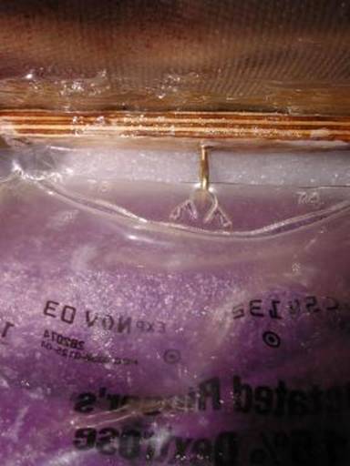

In these photos you can see a hook installed in plywood attached to the underside of the deck. This particular piece of ply is actually the mount for a launch/retrieve handle.
ImageBe creative, it may be necessary to epoxy a piece of ply to the underside of the deck to screw the hanging hook into. Be sure to screw in the hook and cut off the excess threads sticking out of the backside of the ply, before applying any epoxy.
